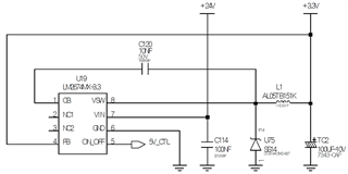

Hi
My customer asked questions about LM2674MX-3.3
LM2674MX-3.3 is used for products in production.
When 10,000 units are produced, two to three defects occur.
Only defective products are being repaired because the cause has not been found.
I'm inquiring because it's an intermittent phenomenon, so I think it's a design mistake.
The defective phenomenon generates noise at the output voltage.
SWAP test A-B-A also reproduces the fault.
Do you know what causes noise in the output voltage?
  • Hello
    Please provide a 'scope image of the suspect wave form on the SW node.
    Also, please provide a photograph of the top of the suspect unit and a photograph of
    the label on the reel of parts.
    From you schematic, you will need a 22uF tantalum or 100uF aluminium electrolytic on the input of the regulator
    in addition to the 100nF.  What is the size of your inductor ??
