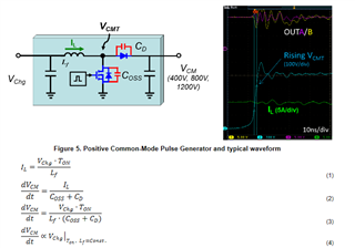

I want to do some CMTI tests on your Gate driver with different slew and I don't know how to do it.
On your pdf (Common Mode Transient Immunity (CMTI) for UCC2122x
Isolated Gate Drivers), you mentionned that you did it with a ESD surge generator. What is the ESD surge generator you use and how you adjust the slew rate.
