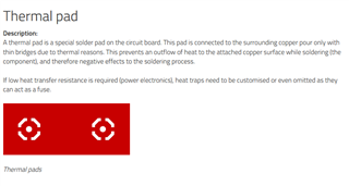

    I'm afraid you missunderstood the "thermals" term. I was not asking about thermal Vias but about the thermal connections from SMD pads to the GND-plane.
    Shall the GND pins be connected with or without thermals to the GND plane (example layout with thermals marked with yellow circle)?

    2.
    Yes, this was one part of my question. the other part was about the thermal pads that you can see (marked with yellow pencil) in my screenshot (from February 15) .
    As an explanation I add the following screenshot:
    Is this "thermal pad layout" recommended for the GND-Pins of the LM2936 as you can see in my screenshot (from February 15) (marked with yellow pencil) on the GND pins (pin 6 & 7) of the LM2936M?
  • Hi Matze,
    1. In that case, I think this is the easiest and most straightforward approach.
    2. I see. We call those "thermal relief connections" to distinguish them. Transient performance is most-optimized when there are no thermal relief connections because each one contributes some ESR and ESL to the control loop. So in regards to performance, using full connections is better than thermal relief connections, but if the device will need to be reworked the thermal relief connections are preferred for easier soldering.
    Nick
