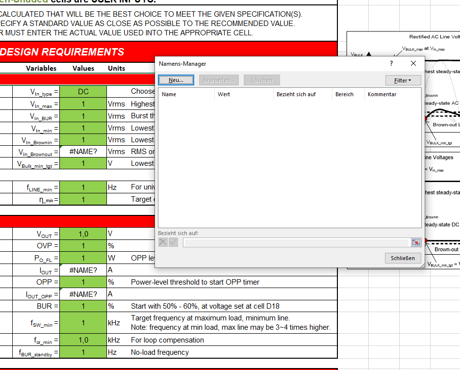

  • Thanks for your
    quick reply.
    i tested the excel, same error. no change in values.
    When unlocked, the problem can be seen, no names are defined?
    Is this only a problem of my PC/ excel? i tested it on 4 PCs (all have excel 2016)
    I have already used some Excel sheets from other chips of Ti  for example LM51xx and it work well.
    So thats why I think the declaration of the names is corrupt. see pictures
    best regards
  • Hello Mister Q,
    Thank you for showing the screenshots of the #NAME issue that you are experiencing.
    Firstly, I'd like to remind you that this Excel Tool has been in successful world-wide use for several years, and although the current revision is at "C", I have never encountered an issue with #NAME errors and complete lack of variable name definitions.
    In an attempt to recreate your problem, I downloaded a fresh copy of SLURAZ0C for the TI website into a test folder and changed the decimal point separator to the European comma (in the Files > Options > Advanced window).
    That successfully changed all the decimal points to commas, to match your view.
    Then I changed "Vin_type" to DC and started filling in 1's in every entry down to row 37, to match your view.
    I found three interesting differences:
    1.  Changing to DC should cause the units in column E to change from "Vrms" to "V".  My did; yours did not.
    2.  When I double-click on cell D21, the formula alignment is to the left, as highlighted below.
    Your alignment above is shifted right, with space at the variable name and the "_Brownin" aligning more under the "Vrms".
    I found this would happen only if I insert spaces ahead of the formula in the formula box.
    3.  I don't get any #NAME errors, and I do get a built-in warning in F34; your example does not get the warning.
    4.  Finally, my Name Manager shows all of the defined variables, even though yours does not:
    Given the above test results, I must conclude that this Tool works as expected for most of the world, but there is something about your PC settings that corrupt the file at your location.
    Unfortunately, I'm not a PC expert, so I don't know the proper system-level settings or how to solve this problem for you.
    I suggest to download a fresh copy and try running the program without unlocking it.
