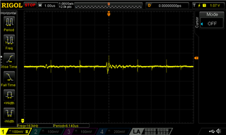

  • Hi Mahmoud,
    After a day of testing I found TPS40428 just one of the nosie source may cause abnormal on my system.
    by the way here are the output waveform I captured at the capacity near the load on board reference from the cap GND
    as shown there is a ~100mVripple at switching frequency
    at the middle is another noise source in 70kHz
    for my system spec I would like to compress the Vripple within 30mV
    Regards.
  • Hi Alex,
    1- What is the TPS40428 switching frequency?
    2- Scope picture shows spikes at 163KHz
    3- I don't see spikes at 70KHz
    4- Is there other frequencies running on the board?
    5-Can you send schematic?
    Please use only one scope probe in Paperclip method and capture the ripple at output capacitor.
  • Hi Mahoud,
    1. by calculation the switching is ~497kHz
    2. I think the scope tracked the wrong peak and give 163kHz
    Please refer to my cursor position giving 495kHz
    3. the 70kHz is from my setup environment power, so I have not capture those noise
    actually the largest peak at the middle is cause by the 70kHz noise with >100mVripple
    the 500kHz noise from TPS40428 Vripple is ~100mV
    4. I have another 5V and 3.3V regulator with 500kHz and 630kHz switching freq.
    5. I have attached TPS40428 sch and loop calculation table in the first post
    Regards.

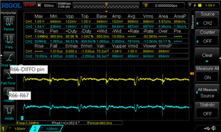

  • Hi Alex,
    Yes I found the schematic. Any loop measurement, in frequency domain, was done across R66? If not, we need to see the bode plots Gain/Phase and make sure the system is stable.
  • Hi Mahmoud,
    As you said I try to capture waveform across R66 and in frequency domain, I hope it contain enough infromation for analysis
