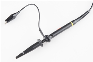

Whether LM63625 HTSSOP evaluation board is compatible to LM63615 HTSSOP evaluation board? Beacuse Iam using Lm63625 evaluation board, on that LM63615 IC is mounted. Whether performance will be same in both the cases? The problem is that Iam getting too much ripple, iam using Lm63615 HTSSOP package on Lm63625 evaluation board. Kindly please confirm it.

  • Hi Gangadhar,

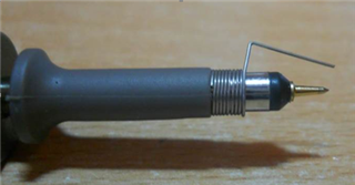

    I read the datasheets and it should work.  Thank you for the scope picture, but I cannot read the time scale. Is the noise repetitive at the switching frequency, or it is at a lower frequency?  Also, did you use the short ground lead probe to measure the output ripple? Note that the long ground lead of a regular probe would pick up noise and produce unrealistic  high voltage ripples. Please use the probe like below when monitor the output voltage ripples.
    Youhao
  • Hi youhao
    Thank you very much for the response.The noise is repeatative at switching frequency as well as lower frequency. I have used the following voltage probe for ripple measurement. Basically I have measured the output voltage directly across output capacitor using tip of the probe, still the same problem. The time scale for the above scope picture is 500 ns/div.
    Gangadhar
  • May I bother you to use the short ground lead probe as I shown earlier and share the scope picture?
  • Thank you very much for your response youhao. I used small wires to mesaure ripple, now its working good .
