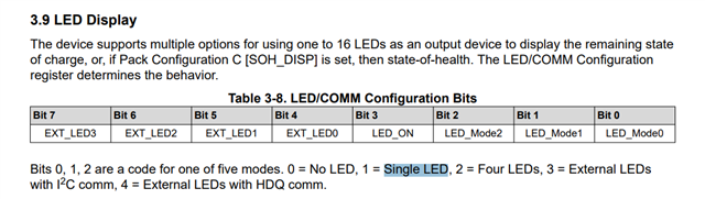

This part has SOC indication that can be multiple LEDs or a single LED. The documented single LED scheme is here (out of SLUSBZ5D pg.39):
  "  Single LED mode—Upon detecting an A/D value representing 2.5 V on the VEN pin, Single LED mode will
toggle the LED as duty cycle on within a period of 1 s where each 1% of RSOC is a 7.8125-ms high time. So,
for example, 10% RSOC or SOH will have the LED on for 78.1 ms and off for 921.9 ms. 90% RSOC or SOH will
have the LED on for 703.125 ms and off for 296.875 ms. Any value > 90% will display as 90%.  "
The part does not do this.

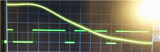

We see 0 to 100% duty cycle signal with a period of 800 milliseconds, for 4 cycles, and then no signal for one 800 millisecond "period".
This entire waveform repeats with a total period approaching five seconds. Having designed a low pass filter around the documented specification to create a voltage indicating SOC, we may find it necessary to increase further our time constants and our settling time, if we cannot find a configuration that will follow the part's documentation.

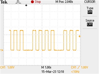

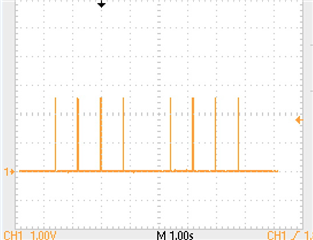

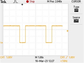

    3/15/23  and update to this waveform. Today during our failed learning cycle this single-LED  SoC indicator  waveform was captured. Soc was at 51% per the gauge interface and the waveform was clearly not what the part specification says it should be. Instead we have an approximately 50% duty cycle signal that drops out every fifth pulse.  There is about a 0.8 second period when clocking.  This is not what is documented in the gauge specification.
    and at 100% SoC the waveform goes to 100%, still with a dropout every "5th" cycle so it turns into an apparent 80% duty cycle at 4Hz.
    end of 3/15 update.

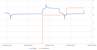

    Failed again trying a learn this morning. not getting status to 05 from 04. Instructions indicate the gauge is not detecting end of charge, even though the "Cell V at Chg Term" state was updated.

  • yet another few days trying to:   load chemistry; setup for NiHM;discharge to empty; let relax overnight (relaxing seems to take longer than TI thinks for NiMH cells) [Vok = 1 status = 0]; enable IT [vok = 1 status = 4]; normal charge at C/2 until voltage or temperature peak; let relax overnight [vok = 0 FC = 1 status = 4]; start discharge at C/5 [Vok =1 FC=1 status = 4 ]; continuing discharge [Vok =1 FC=0 status = 4 ];
    So the status update to 5 continues to elude us.

    5/19 am update
     (Blue is voltage, orange is learning status) Here we all see a discharge, a long relax, IT enable and start of charging that changes the learning status to 4. At the end of charge, and the relax that follows, the status does not change to 5 as SLUUBW5A says is expected. After a 5 hour relax, a discharge and another hour wait the status then changes to 5. Again not the expected actions. History has shown us that not until the end of another charge with relax and discharge with relax will there be a status change to 6. We will continue this test to see that repeat.
    5/20 am update
    We find again that only after the second full charge and discharge cycle do we get the status change to 6. This is not in line with Figure 11.4
     Status only changes one hour after a discharge..
    MCIA may17 to 20 status not changing as expected.zip complete log and .gg files

  • Back to our original reason for starting this thread 3 months ago:  The single LED action also conflicts with the documented and expect behavior based on the same manual, Sec. 3.9 LED Display pg32. It says the period of the single LED is one second with a 781mSec on time representing 100% SoC. Your description of the interface aligns with the manual, but not with the behavior of the part.
    The part itself has a period closer to the 0.8 seconds, never goes off during the four periods (if representing 100%), and then goes off for one complete 0.8 second period while it updates what will be displayed. Not a short time in the scheme of things here. It would be helpful to have the manual corrected in this area too.
    We hold Ven active to get a continuous display that is then heavily filtered to provide an analog representation of state of charge without needing to use the I2C bus. This works, once corrected for actual behavior, except for the occasional time when the gauge turns off the LED for not one but two peroids during the "update" off  time. This extra off time throws the filtered analog representation off and while it happens only once every 1 to 10 hours, this maybe enough to generate concern and questions from customers. It certainly has caused concern at the bench for our desired unit functionality.  It would be great if the reason for this occasion glitch could be found and corrected.
     This (green trace) attempts to show the LED on times for four periods (100%SoC) and off for one period normally, along with one instance of the off time being twice as long as normal with the filtered analog being thrown low (yellow).  [ one second per division ]
    Will this gauge require occasional two full charge/discharge cycles to update Qmax and the resistance table in the field?  Our application is such that it may not get fully discharged on a regular basis.

     We see the updated status during the learning cycles at just a little over an hour after discharge was ceased. You say Qmax will only update if the cells are left to relax for five hours in a discharged state?  Is this the only way Qmax will update in the field?

  • well this was a surprise. Changing the LED tic count from 4 to 10  shortened the "off" time substantially.
  • >The "short time" is actually one tic time, and randomly two.
    This is plausible because of how the interrupt is handled (via a HW timer) so it should be multiples of a 7.8125ms tick, depending on how the thread that restarts the process is scheduled relative to that HW timer. I don't have profiling data but what you report aligns with the code.
    No. The five hour timeout is a default hard cut-off when the gauge will force an OCV measurement which eventually (other rules apply) causes a Qmax update. In a real system, if load in relax is low enough for voltage to stabilize, the gauge will not wait 5 hours but take OCV measurements and calculate Qmax as soon as the voltage is stable.
  • Dominik,
    We are finding now that the SoC indication with the single LED may only go to a minimum of one tic (7.8mSec) time on and not to zero. Can you verify this, before we add a feature to subtract from the filtered average of this signal?
