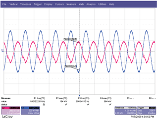

Hi JC,
it supposed to look like this
like when we did a test for Ripple voltage test
but i don't know why the result like yours (i got the same result like you)
Thank you
Hi, is the blue waveform your input ripple? There's no equivalent found in the simulation so you cannot expect any output ripple.
-JC
Hi Ihzany,
Please replace V2 with a VSIN in order to inject the noise voltage. The PDF says VAC but it means an time variant source, not the SPICE primitive VAC.
