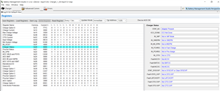

my customer finds its CHRG_OK signal keep high and low constantly
they checked 0x20 fault register, but nothing trigger.
something is not right, is there a direction for us?

Hi Fred,
I would suggest monitoring the system current and adapter current as well. It looks the VSYS is pulled to low when the CHRG_OK asserted.

Hi Tiger,
here's adapter current and discharge current in IBAT.
but like I said, there're no fault in 0x20, and VBUS is normal.
so we're confused what's the root cause.
please guide us, thanks
Hi Fred,
I noticed STAT_VDPM was triggered the PROCHOT status. You can lower the input voltage register 0x3D to see if it continues to trigger VINDPM.
For debugging purpose, you may enable other PROCHOT options bit to see if which event triggers.

below is the EC log,
I do see they keep writing 0x15(max charge voltage) to 8.8V every 3 sec which is would be BATOVP in 3S setting, right?
please help double check carefully .
"229C" is 8.856V, please help check
Hi Fred,
Great progress on troubleshooting this issue.
The EC log showed periodically write "229C" (8.856V) to max charge voltage register. It would trigger BATOVP for a 3S battery. The BATOVP is not a latched fault. When a new value "3390" (13.2V) is written, it is back to normal operation. Thus showing as a periodical CHRG_OK assertion low.
In the future, we could monitor SDA/SCL together with CHRG_OK signal. This way, we can trace back to the EC command quickly.
