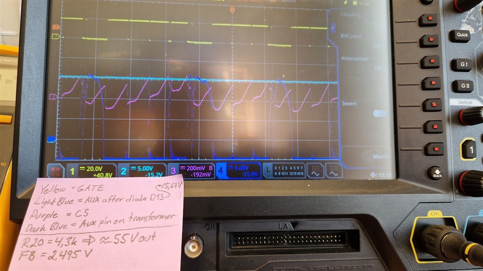

    We tried setting R20 = 4.3k. The duty cycle becomes very high under no load and it consumes around 100mA which heats up the switching components. Seems that it goes into high DC mode because the FB goes <2.5V. (Photo below)

    1. The CS signal is not good - the measurement appears to not be referenced to GND. Is this the measurement taken directly across the CS resistor which is GND referenced?
    2. The converter appears to be oscillating due to subharmonic oscillation? If you designed the converter for peak CMC with max duty at min input voltage which is supposed to be 650 V but you are testing at 200 V, what is the theoretical duty cycle under this condition? I expect much greater than 45% and this would create the instability you are seeing?

    3. The aux winding is not dropping out because there is no load on AUX. It is acting as a peak detector so that even though the duty is changing on the main output which is loaded and the main output is being reduced with load, I suspect the AUX output is being held up by whatever capacitance is on AUX. Adding even a small load to the AUX winding should show that it will drop proportionally according to the main output.

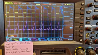

    FYI increasing Vin to 600V did not do any help.
    Another problem we have is - if we reduce R20 to 3.48V (to output 68V), Vfb does not reach 2.5V so it runs in high duty cycle to try and reach that 2.5V. My understanding is that it does not reach the 2.5V because Vcs reaches 1V and overcurrent triggers which turns off the gate and Vout does not increase anymore.
    It seems to work with R20 = 5.1k which sets around 55V, then Vfb reaches 2.5V and the duty cycle is low as it should.
    I think that Rcs needs to be reduced a bit so the Vcs wont reach 1V as fast which means higher higher duty cycle for a short time until the Vout reaches 68V and Vfb reaches 2.5V, then it should into lower duty cycle. Am i correct?
  • Waveforms look much better - sound correct, like you are on the right track. Make sure your max duty cycle is happening at minimum VIN and the CS resistor is sized appropriately so that you don't cross the threshold during normal  operation.
