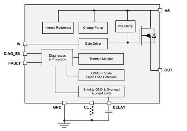

    We aren't able to provide any detailed level view of the internal device circuitry as this is considered proprietary, however the block diagram in the datasheet should give a good understanding of what is happening in the system:

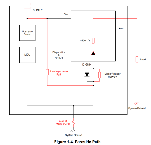

    What I believe is happening here is with the double fault condition they are running into the parasitic path described in https://www.ti.com/lit/pdf/slvaes9 100
    It does sound like there could be some application variables in this system like other parasitic paths or soldering/setup issues. To make sure to eliminate all variables, please try to work with the local TI team to get an EVM so that you can test with a known good setup.
