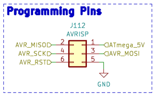

  • 3. During the manufacture process of PCB, it is any configuration about the programming burning? We saw there is a programming Jumper in SCH. I mean, during programming burning, if input is floating(battery is disconnected.) but force a 5V voltage to the output side of TPS564247, this may cause the damage risk.
    https://www.ti.com/lit/an/slyt689/slyt689.pdf Please refer this application note.

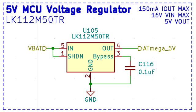

    3. The Atmega_5V is not directly connected to the 5V power rail of the TPS564247. Atmega_5V is a different power rail created by the regulator shown below and is only used to power our Atmega MCU. We did not supply the Atmega from the 5V TPS regulator because we wanted to be able to turn the regulator on/off in the future via the enable pin. However, this does highlight another good point. We'll add a diode in the next design to the output of our Atmega_5V regulator. We did program the MCU and supply Atmega_5V with external power through the programming pins but the TPS regulators continued to immediately work afterwards and only failed weeks later.
