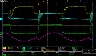

I'm developing board based on UCC256403, in order to well understand the operation. I dowload the simulation model of "CC25640x Simplis Model" from web. It work well as original setup of 380V in 24v vout.
But our design is 380V in and 60v out, I updated the Lr, Lp, Cn and turn ration as what our board as. But the simulation result is not right. The vout value is not right. How can I revise the model to simulate my design? What's parameter set need to update?
