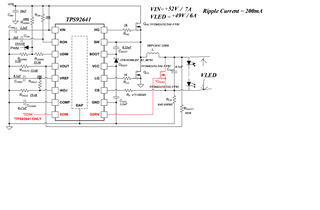

I am trying operate LEDS through TPS92641EVM with below spec
Vin= 52V
Iin = 7A
VLed = 49V
ILed = 6A
Ripple Current: 200mA
    How to calculate the UDim frequency range for the operation?
   Kindly support for schematic verification

    • In general, PWM dimming frequency (the UDIM frequency you mentioned) should be at least one order of magnitude lower than the steady state switching frequency to prevent aliasing. However, for good linear response across the entire dimming range, the dimming frequency may need to be even lower.
    • Regarding your schematic, your current setting is around 6.67A. Consider using a 0.033 ohm sense resistor to achieve the 6A target.

    • One concern is that your Vin = 52V, Vout = 49V, the only 3V dropout voltage may be too low for TPS92641 to function well.

         yes, By using TPS92641EVM UDIM pin i am dimming the led below components are changes
    Mosfet : STD100N10F7
    Inductor : 22uH
    C2 : 10uF
    R10 : 0.03 Ohm
    R1 : 38.1 K
    R7 : 445 K
    Vin : 52 V (if recommended, i can adjust 53V max)
    Iin : 7A Iled : Max 6A (Kindly share your recommendation)
    Vled : Min 49V (Kindly share your recommendation)
