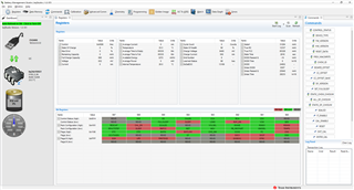

I am testing with a combination of EV2400 + BQ34Z100EVM. I'm facing some problems out of the box.

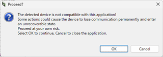

"Auto Detected Device" shown by bqstudio does not match 0100_0_16_BQ34Z100G1.
"Finish" was clicked. the error is displayed. "The detected device is not compatible with this application!"
I guess it's probably because "Auto detected Device" is not properly recognized.
The dashboard comes up, but the battery gauge is grey, showing 832mV and 0%. The cell voltage was measured by a multimeter, and the BAT terminal ~ BAT- of BQ34Z100G1 was 4.14V. The value is not reflected in bqstudio.
I updated the firmware of EV2400 referring to SLUUBV2. v0.18 to v0.32. But the problem remains.
