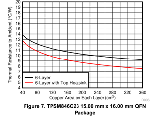

Figure 7 in the application note (SNVA848A) provides with heatsink data.
Please tell me more about this heatsink.
This module top side is inductor, is it OK to attach a metal heatsink?
Hey Hirotsugu,
Regarding that graph, the heatsink was tested on the IC package itself, not the inductor. For the IC (QFN, clip), we have experimental data that shows 200N of force is acceptable.
This does not apply to the module, however, as the top side of the module is the inductor, and we do not have force limit data on the inductor pins/solder joints. Assuming that the heatsink is electrically isolated, I don't see why you couldn't experiment with attaching a heatsink to the top of the inductor.

Hi Caleb,
The IC is under the inductor, how did you attach the heat sink?
Or is the graph TPS546C23 instead of TPSM846C23?
Hey Hirotsugu,
It seems I was mistaken. You were correct in that the heatsink was placed on top of the inductor for this application note. We don't have any information on the heatsink, however. It is likely that the heatsink had the same area as the inductor and was glued to the top of it.
Regarding heatsinks in general: From mechanical/reliability perspective, the customer will have to test and evaluate their design (thermal interface and how heatsink attaches and touches the module) and ensure it meets their qual/reliability standards. A concern with heatsinking would be that the heatsink would apply stress on the module and solder joints, so the customer is responsible to evaluate and test their design meets their lifetime/reliability requirements. We do not have specific guidelines on heatsink design or application.
