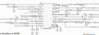

BQ25892: VSYS below 3.5 V when VBAT<3.5 V
Part Number: BQ25892
Hi, im designing a charging circuit with the BQ25892. However, when the battery voltage drops below 3.5 V, VSYS is not regulated above 3.5 V. VSYS has unfortunately the exact same voltage level as the battery.
I measured the following voltage levels at the GPIOs:
  • QON: 2.84 V
  • OTG: low
  • CE: low
  • PG: low, when Walladapter connected
  • STAT: low, when charging
  • PSEL: low
  • ILIM: 0.143V
  • REGN: 4.57 V, when Walladapter is connected
  • INT: 2.84 V
What could be the reason for VSYS to be <3.5 V?
