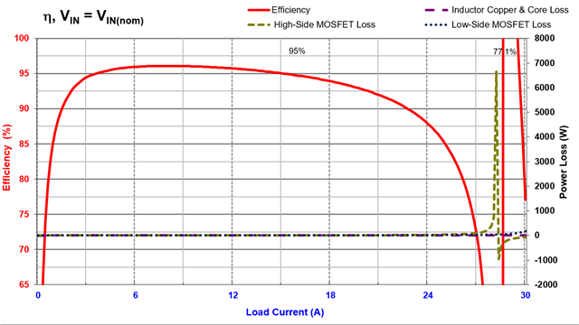

I'm trying to use LM5146-Q1 and I saw its maximum current rating said to be 30A on TI product search.
In my understanding, the max current spec must follow FET's current spec, but I was wondering why you put certain number on max current.
Is there any reason?
Also I tried the calculation excel file, and the power loss analyzer graph shows a weird behavior when load current exceeds 20A.
Is that normal?
Thank you in advance!
  • Hi JH,
    Practically, 20-30A is the limitations of the FET power losses, usually RDSON and respective I^2*R losses.
    It looks like your high-side FET is seeing significant power loss after 20A. You can try a lower RDSON FET but at some point this issue will still occur.
    You really dont want more than 1 or 2W of losses on each FET, unless you have heatsinking or cooling.
    Most Si FETs have RthetaJA of 40-50 C/W, so for every watt of power dissipation you'll see 40C temperature rise.
    Hope this helps,
    -Orlando
