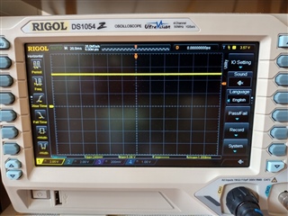

I'm trying to use TPS54302DDCR for a 24V to 5V / 500mA step down supply with the following layout and components. I seem to get output voltage glitches when at around 100mA load where the voltage drops 1-2V for 100us and beyond 250mA the IC goes into some sort of PWM / shut-off where I can see voltage pulsing between 500mV and ~2V. Is there something wrong with the layout ? Thanks

    This is how it looks without load
    No Load
    Glitch with 250ma load
    Shutdown at 400ma

  • Thanks heaps Young, that is very helpful. I'll make the suggested changes.
  • Hi Young,
    I made the recommended changes, but I've still kept the ground on pin one going through a large via with solid copper infill. The change has improved the response, I no longer see the converter going into a shutdown at high load (500mA) but I can still see the periodic glitch where the output voltage drops to 0V and goes back up again. I've played with inductor choices going up to CDRH74NP-100  (10uH, 1.84A, ~50mΩ DCR).
    Any idea where I should be looking to fix this ? Thanks
    what happened during this  periodic glitch?
    and if it's possible to get one EVM to replace the current layout/design on our board , to check if no issue with EVM ? or still can repeat ?
  • Hi Young,
    The test setup feeds in 24V 1A max (CV/CC) with an Agilent U8002A, constant current load at 250mA. When the glitch happens, I can see the input current spiking and dropping back. I've added an additional 330uF capacitor close to the input and an additional 330uF capacitor at output to smooth out at spikes.

  • Hi Young,
    I think I fixed the issue, no big changes to the layout. I changed the inductor to CDRH104-100NC and added an extra 22uF input bypass and an extra 22uF output filter capacitor.
    I'm not sure what the original issue was, but no glitching in 2 test boards so far. I kept the design as is since it allows me to have a solid ground plane at the bottom and the output noise / ripple is low <100mv at 750mA load.
