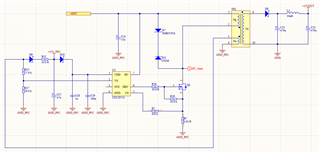

In our application, we also need to draw current from the auxiliary winding (approx. 50mA / 15V). But if we load the AUX output, the voltage drops to 10V (with 50mA) immediately. We use a similar connection as in TIDA-00173 (VAUX).
Some Informations:
Input voltage 380 - 420V
Output 15 V / 0.5A
Auxiliary Output 15 V / 0.05A
Primary Inductance 2.37 mH
Switching frequency 90 kHz
Do you have any tips how to fix this?
Thank you

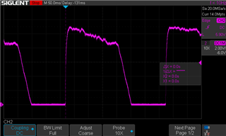

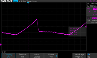

    I rewound the transformer and add 4.7k ohm resistor to output, but problem is even worse.
    When I load the aux output with 5mA, the output drops to about 11V. When I load the output with 10mA, the output starts to oscillate between 11V and 0V, see the waveform from the oscilloscope.
    This waveform is on the capacitor C27:
    This waveform is on the capacitor C29:

    What is your +15V output at these conditions?
    I mean what are +15VOUT and +15V_PFC when you loaded 5mA to which and where did you put 4.7k resistor?
    both waveforms are from +15V_PFC. 4.7k resistor is on +15VOUT and 5mA load is on +15V_PFC.
    If i load 10mA od +15V_PFC, on +15VOUT is 18.2V.
    It looks this confirms the issue due to the transformer two windings not coupled tight enough. Basically the +15VOUT is with a voltage higher than the intended regulation point 15V and this voltage is sensed by the controller so to decide to make narrower or no pulses, it means the controller does not know the drop of +15V_PFC.
    A load of 4.7k on +15VOUT is too small to have proper cross regulation. You may try to increase the +15VOUT load to > 50% of its rated load, then loading +15V_PFC with 5mA to see if the situation gets better.
    Also, you can try to short R32 to see any improvement.
