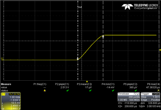

The datasheet specifies typical tSTR (start-up time) is 600us at VOUT = 3 V, RL = 30 Ω, COUT = 1 μF.
My customer would like to know the maximum tSTR for TPS73733 and TPS7373301 (Vout=3V) respectively at RL = 30 Ω, COUT = 1 μF.
