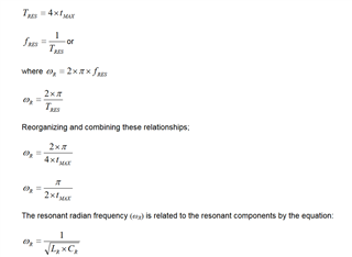

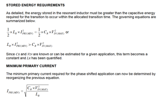

I am trying to understand the sizing of the shim inductor for the PSFB.
I'm trying to use the note Application "SLUA107A".
I understand that there are 2 conditions for applying the ZVS:
1) Energy of the shim inductor > Energy of the FET capacitor + Trannsformer.
2) In relation to the Tmax and the resonant frequency.
What does Tmax correspond to? Does it correspond to the rise time of a transistor (Tdr), the rise time (Tr), or something else?
Can you shed some light on the subject? And how do you dimension the shim inductance on POWER STAGE DESIGNER?
