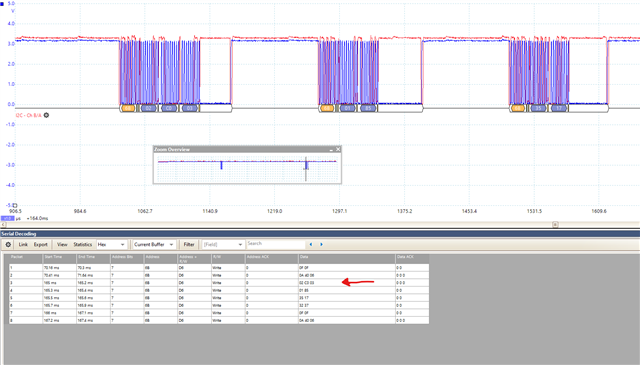

We are having an issue on the I2c bus when the PD chip communicates with the charger chip (BQ25731). The clock line is stretching when we switch/request a different voltage level using an external PD SINK device.
We have our own custom board based on the EVM.
The above is tested with the GUI-generated firmware using the TI tool for firmware customization.
This is the configuration file:
{"questionnaire":{"version":"7.0.4.6","answers":[0,3,3,0,1,2,1,null,1,null,2,12.6,1.536,null,null],"options":{},"configID":"0000","vendorID":"0000"},"configuration":{"data":{"selected_ace":[{"register":6,"data":[0,0,0,0,0,0,0,0]},{"register":22,"data":[10,48,48,77,0,0,0,0,0,0,7]},{"register":50,"data":[4,168,42,44,145,1,38,44,209,2,0,44,177,4,0,44,65,6,0,0,0,0,0,0,0,0,0,0,0,0,0]},{"register":51,"data":[4,44,145,1,16,44,209,2,0,44,177,4,0,44,65,6,0,69,65,6,0,0,0,0,0,0,0,0,0]},{"register":92,"data":[240,0,0,0,0,0,0,0,0,16,0,0,192,0,0,0,48,0,0,0,0,0,0,0,192,12,0,0,0,0,0,0,0,0,0,0,0,0,0,0,0,0,73,75,0,0,0,0,0]}]}}}
We've probed the line to monitor the data traffic and here is what we got:
the above sets the charge chip otg voltage to 20v, this is set correctly but no further I2c communication between the two chips "clk line is held LOW" .

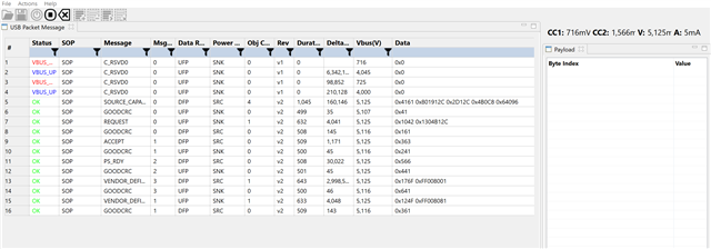

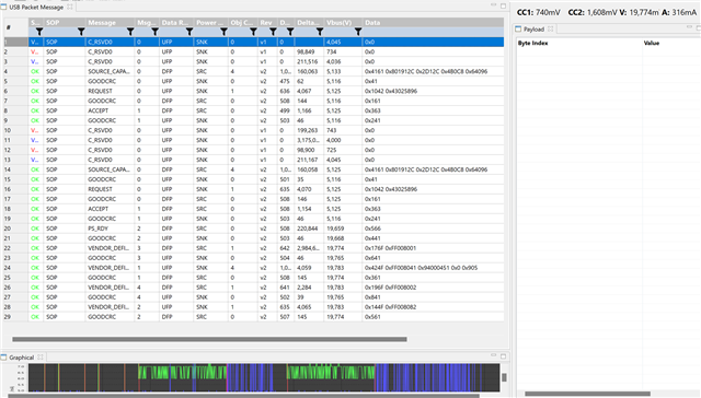

    I have also attached  screenshots of PD logs  of the recent binary. They show the logs for when connecting the port to two different wall chargers.
    The source capabilities message in line 9 contains these "0x4161 0x801912C 0x2D12C 0x4B12C 0x6412C".
    We kindly request your assistance in providing us with an updated file as quickly as possible, as we are currently in a critical stage of development.

    Both of the files you've sent did not work, as you can see in the screenshot the source capabilities are received but the PD chip always requests the first PDO, and also the charge voltage and current are not set.

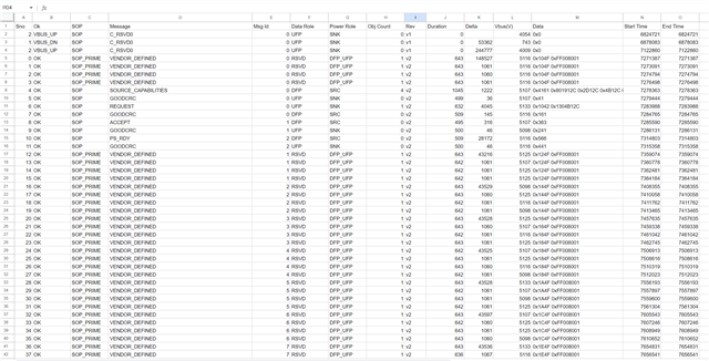

    Here is the link to a document I made with some screenshots of the logs and I2C bus:
    https://docs.google.com/document/d/1moggqyx7BrRQGBLvtF65MxX602VnSWg-/edit
    Here is the folder for the source files and images if needed: I have screenshotted everything in the .word document.
    https://drive.google.com/drive/folders/1QUAeeoJSUVQ3CDTM2coVY_fZfemcLWXq?usp=sharing
    To view I2C logs from source file “.psdata”  you need to install this software: https://drive.google.com/file/d/1NH_Dez0HasuGXmOaZ6qG0Dw0B5HYrZeu/view?usp=sharing

    • When plugging into a DRP the PD chip makes a successful contract and becomes a source and provides power to the sink device, but tracing the I2C, it looks like the I2C clock stretches and stays LOW until we do a hardware reset every time. It happens only when we connect to a DRP port. We had this issue before, it was the issue we opened this thread for and we got it resolved previously (in Jun 23 in file “ahmed_final_binary.bin” sent by Conner, but it looks like it’s back again with this binary file.
    PD Logs “source file name (PD_LOGS_DRP_SRC.ccgx3)”:
    No issue on PD logs, and the power is set to 20V 3A

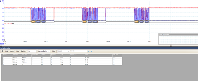

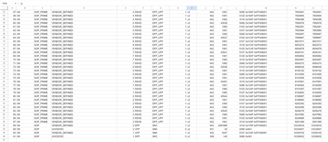

    I2C Logs “CLOCK STRECHING” “source file name (DRP_SRC_clk_stretch.psdata):
    • When plugging into a wall charger that supports PD, the clock stretching issue does not appear however, the charge current is not set correctly. The logic analyser I used misses some of the data so you might not see the whole I2C logs in this capture, but I went and read the corresponding registers on the charger chip. Charge Current Registers 0x02 and 0x03 are set to 0x80 and 0x00 which is not correct.
    Charger Chip Regusters
    PD Logs:
    Drawing 300mA only
    I2C SCOPE CAPTURE, “SOME LOGS MIGHT BE MISSING”:

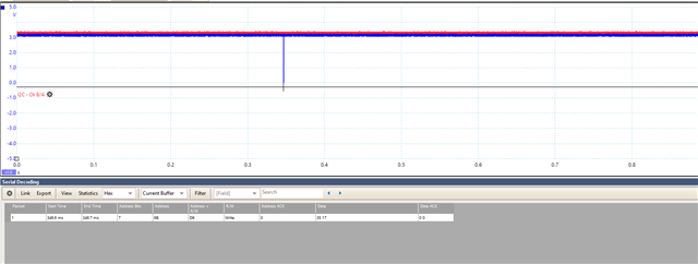

    I have captured two issues not just one.
    first one is the charge current not being set correctly.
    The other issue is I2C bus crashing "clock stretching forever" when connecting to a DRP, PD contract is successful and the charger is configured but the I2C bus crashes immediately and we no longer have I2C comms. This is a similar issue to the one we had at the start of this thread you can go through the early messages we had with Conner.
    Blue: I2C clock.
    Red: I2C data.

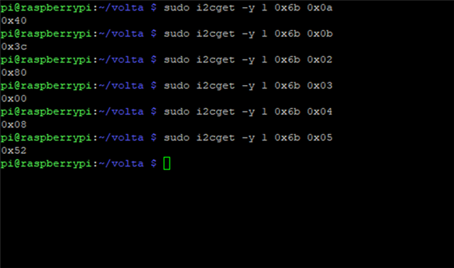

    The recent .bin file fixed the two issue!!
    however, there's still a minor issue, when the port is connected to a partner DRP and when TPS25750 becomes a sink or we perform a power role swap from source to sink, the charge current is not set correctly.

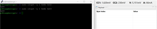

    when in sink mode the charge current registers (0x02 & 0x03) should be set to (0xc0 & 0x03), which works well except in the case I mentioned.
    I probed the I2C line and I saw the data being sent from the TPS25750 to the charger chip (0xc0 & 0x03) which looks fine:
    However, reading the registers in the charger chip afterwards returned these values which are not correct:
    And when I try to change the registers value manually through I2C it does not accept it.
    I have checked the register 0x20 in BQ25731 to see if any errors but no errors were shown.
    Another question, when we perform a Data Role Swap to UFP, is TPS25750 meant to do reset it self?
    Ahmed
