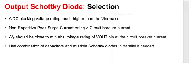

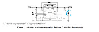

can you tell what is the purpose and how to select schottky diode on output, page 38 figure 11-1 in Datasheet?

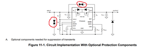

2) In what scenario can we use bidirectional TVS2701 instead of SMC diodes for selected diodes below? (Vin_max working voltage is 25V)
is it ok to use TVS2701 if surge level is class2 1kV 42Ohm?
