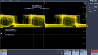

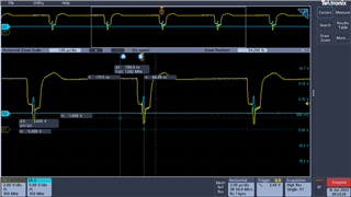

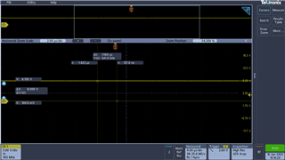

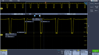

when I apply 12VDC at the input with no load, it only gives me 2.9VDC at the output and not the 5VDC I expect.
I attach the images of the switching signals.
low output
high output
both
blue signal = low output
yellow signal = high output
