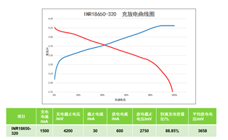

  • 1) I measured the battery voltage is 3.68V (removed external adapter from VBUS). Based on below charge curve, it only reaches about 50%. So it's far away from fully charged.
    2) After 9 hours charge, battery voltage reaches 3.94V and the charge current drops to 250mA. Anyway, it's too slow.
    3) Additionally, I also check external VBUS input supply limit is 4A, which is much higher than 3.25A.  So the input has enough current capacity to charge.
    Are you performing you test on our EVM or a custom board?
    Your chart appears to show that battery voltage reaches approximately 4.2V during charge and the read for REG0E matches this. You may have a large amount of parasitic resistance between the BAT pin and your actual battery terminal. The BQ25890 is only able to measure battery voltage at the BAT pin. If during charging that pin reaches VREG the device will reduce charge current until termination is reached.

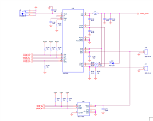

  • Here is the schematic
    Thank you for providing information on SYS current draw. I have also reviewed your schematic and all looks okay.
    Please help to share a waveform capture of VBUS, VBAT(measured as close to BAT pin as possible), and IBAT when you observe charge current lower than expected. In the test please cut off system load to eliminate that variable. Please also provide a full register read when you observe the low charge current.
