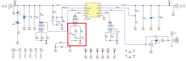

Hi, LM73100 support team
In LM73100EVM schematic, a series resistor is added to a capacitor on dVdt pin. This series resistor is not considered in Design_Calculator. In this case, how to calculate the soft-start time?

Hi Tamio, Formula will remain same with and without resistor.

Hi, Kunal
I understood that the same formula can use for without a resistor. By the way, what purpose is a series resistor?
Tamio
Hi Tamio,
It is for limiting current through a FET between dvdt and VOUT. There is switch that short dvdt to VOUT after startup is complete.
