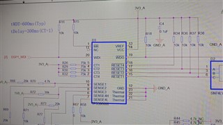

I want to use two PCS TPS386000 to monitor 6 channel power, one PCS TPS386000 has watchdog and another one I want to disable watchdog, Could you please help if this function is ok ? Thanks .

The watchdog on TPS386000 cannot be disabled. For the channels not needing watchdog, I recommend using the following device. Hope that helps.
https://www.ti.com/product/TPS3704/part-details/TPS37044BJOFDDFR
Hello:
Thanks for your sharing, Please help check attached schematic if it can work well . Thanks .
Yes, the attached schematic looks good. What is the resistor divider configuration on the sense inputs?
