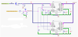

I have a schematic which has two TPS16530 devices with their outputs tied together. This was done to increase the current carrying capability.
Is this a valid configuration? I don't see anything in the datasheet that says that this is something that can be done.
