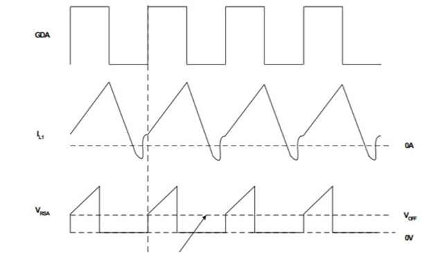

UCC28070A's data sheet has Equation (18) to select RIMO value. But if a signal voltage at CSA and CSB pins has DC offset, does it have an effect on the Equation (18)? I'm wondering if I need to subtract the DC offset from the equation, for example.

    The DC offset is generally limited to between 100mv - 150mv (200mv max). It does not have any effect on equation 18 on selection of Rimo resistor.
    The  offset adds a small DC error signal to the CSA and CSB signals. It is just a DC voltage that stops gate drive that would otherwise would result due to an erroneous current transformer signal. The effect of this offset is to add a "dead zone" around the zero crossing.
    During this time when Rsa is below Voffset (the DCM time mentioned in the datasheet) the gate drive may go to full on because the sensed current is zero and the error amp has a finite output. This may saturate the current amp and cause large spikes of current around the zero crossings. Adding an offset on CSA/CSB prevents these large current spikes and generates a dead zone. This is mainly having effect at zero crossings where at low line voltages the current transformer cannot sense an adequate line current because the current into the CT is is so small and parasitics and ringing cause measurement error.
    Overall no need to make any changes to the equations.Please let us know if you have further questions.
