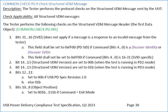

      We test PD Compliance (2023, Q3 CTS) with Lecroy analyzer.
      TPS64994AE FW base is F609_06_12., GUI tool is 6.4.30.
      Please double check below two issues and help us fixed those issues.
     1. The tester checks the Bits 12…11 in Structured VDM Message Header in COMMON.CHECK.PD.9.
       Bits 12…11 needs to be 01b else USB PD Spec Revision 2.0.
     2. TPS65994AE has a fail item in TEST.PD.USB4.EUSB.5 – tEnterUSBWait check for USB4 DFP
From trace, TPS65994AE sends another Enter USB message within tEnterUSBWait min. And there is an unexpected message.(Packet#138)
