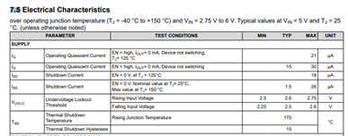

  1. We have observed input current of around 20mA for the TPS62812QWRWYRQ1 on no -load. Since we are using it on Standby, this current is way too much… As per the datasheet, the no load operational current is around 21uA. Can you please help confirm this?
