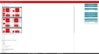

    Here is the TPS25750 Application Customization Tool setup (I am not using the battery charger for my test) :

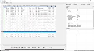

    I can see on the CY4500 EZ-PD Protocol Analyzer Utility that the profile was accepted by the source. Here's the exemple for the 1.5A profile :

  • Hi Marc-Antoine Dion,
    When sinking with the TPS25750EVM, we only specify an undervoltage protection threshold for the PP5V signal on the 5V power path, which you are using. The threshold is around 3.8-3.9V. A 1V drop to around 4V is not uncommon on the sink side for VBUS, I also saw this in my testing. Since you are applying more current, the voltage drop increases naturally and is not unexpected. You will sink 4V instead of 5V but you should not have an issue in terms of PD function or UVP protection.
