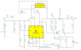

I keep getting convergence problem using CSD18536KTT & LM5069-2. Was able to simulate the same circuit using other TI mosfets.
Request to assist.

Thanks for your interest in TI FETs. Can you please share your TINA-TI simulation with me? Some of our mid-voltage (40V - 100V) FETs use tabulated capacitor subcircuits to reflect the non-linear nature of the parasitic capacitances in the FET including the CSD18536KTT. Sometimes these models result in convergence issues in certain simulations. You might try adding a small gate resistor to see if that helps. Otherwise, I can try to modify the FET model to use fixed capacitance values to see if that resolves the issue. I will try this on your simulation if you can share it with me.

Apologies. I'm using CSD18540Q5B FET. Attaching the TINA simulation file.
Hi Vinod,
I'm getting an error when I try to open the .tsc file with TINA-TI. I tried both the earlier file and the one starting with 0317. I am going to send you a friend request thru this site and then you can put the simulation file into a zip file and attach to a private message to me. If that does not work then you can email it to me. I'll send you my email address in a private message.
