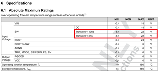

Could you please provide VIN transient (AC) spec as below DS shown SW spec?
I can only find VIN DC spec is 18V but no transient show in DS.
Hi Jim,
Please see below for the VIN transient (AC) spec:
