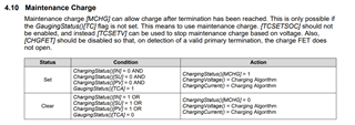

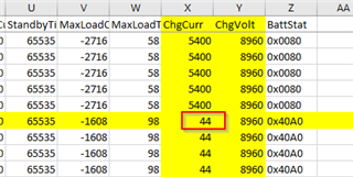

BQ28Z610-R1: VCT condition of cell voltage,average current,and two consecutive 40s are reached,but FC cannot change to 1
Part Number: BQ28Z610-R1

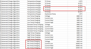

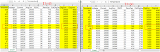

I use BQ28Z610-R1 for 2S1P Battery,we set taper current 3950mA,cell voltage +45mV≥4530mV for Rec Temp Charging(15~45℃),cell voltage +45mV≥4480mV for High Temp Charging(45~60℃), and two consecutive 40s . When we charge the battery,VCT conditionit are reached,but FC cannot change to 1. I suppose when VCT reached the current should be between 2500 to 3000 mA but it actually at 1000 to 1600mA.
Please tell me the reason as soon as possible.Thanks.
Attachment are the gg file,srec file,an log file.VCT NG.zip
