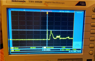

    How do you judge below picture? It's an issue or not.
    It's caused by big capacitor during power up.
    5A/Div.
  • Hi Liping,
    Where is the current being measured? Is it the battery discharge current from BAT to SYS after battery is plugged in? Also can you share what the time/div in the waveform is as well? It is hard to tell from image.
    Garrett
  • It's from BAT to SYS (no power adapter connected).
    Timebase: 2.5ms/div
  • Hi Liping,
    Based on our recommended operating conditions ideally you want to reduce the magnitude of the current spike below the recommended maximum discharge current of 9A.
    In reality since the BATFET_OCP protection is not turning off the BATFET as a result of this behavior at power up from battery it should not be an issue.
