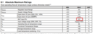

  • Hi Anthony,
    I followed the instructions. But it does not work. Can I damage the Eva Board when I use wrong settings J2 and J3? Could be I applied 12V in setting "1S".
    Patrick
  • Hi Patrick,
    Yes, you can damage the board if you are using 12V with a 1S configuration. Typically, lithium ion batteries are around 2.2V to 4.5V for each cell, so if you are looking to source 12V into the BAT+ and BAT- of the EVM, you might want to look into the 2-4S configurations. On the EVM, the absolute maximum voltage inputted into the BAT pin of the bq35100 is 5.5V found in the datasheet, so the right configuration of J2 and J3 needs to be in place for this to work.
    https://www.ti.com/lit/gpn/bq35100
    Below is the section of the circuit where you can drop the 12V to the correct voltage through using the resistor ladder connected to J3. This can help you choosing the correct configuration.
