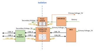

Hello TI Expert,
Could help to evaluate the below concept ?
I am not sure whether I can directly use primary voltage (use for MCU and other load , load parameter about 5V/ 700mA)  and secondary voltage (use for CAN transceiver,load parameter about 5V/150mA)  for load.
Please share your suggestion.
By the way , could you share me the output voltage accuracy of primary voltage and secondary voltage?
