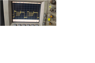

The damping RC circuit is already in place. But C value is same as C86 and not 5 times. PFB the 5 v generation portion which is used as input to LM20133.
The same 5 v is used to power 3 more modules which are basically relay based I/O modules.
Consider these factors also.
Please suggest some measurement points which can give clue on the stability of the regulator.
I have observed the waveform at pin 8/9 of LM20133 and its appearing as below, is this point of concern. What is the expected output at this point?
