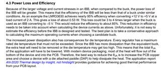

My customer use TPS62088 to provide -2V output voltage form 3.3V input voltage and the output current is about 0.3A. And per the customer replied, the efficiency is about below 80%. It seems reasonable per the AN SNVA856B https://www.ti.com/lit/an/snva856b/snva856b.pdf?ts=1695125826738&ref_url=https%253A%252F%252Fwww.ti.com.cn%252F

    We want to find a different device. The customer replied that when they use TPS62088 as IBB application, the efficiency is below 80%, about frequency or Rdson which of them is the main reason? If we find a low frequency Buck, can we improve the efficiency?

    The efficiency numbers you shared looks realistic when using TPS62088 in an IBB config. To get a better efficiency, the losses need to be reduced.
    There could be some improvements if you change the frequency or inductor. However, this may not be a considerable change in IBB Config.
    In any case, please use our latest devices like the TPS62824/5/6 for newer designs.
