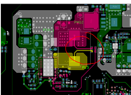

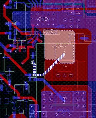

Hi team,
can they use this connection to connect the C1 and R7 close to inductor?
is this better or recommendation?

yes,
R7 and C1 are near the inductor.
The C2 is near device.

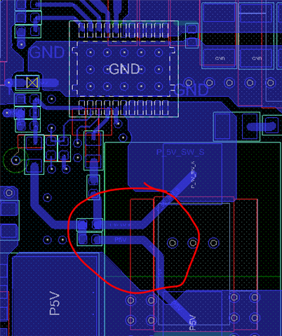

Hi David,
please check again,
customer revise ripple injection circuit as below,

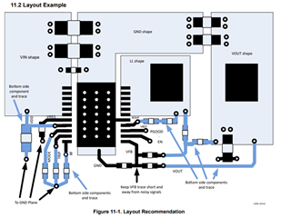

I think connecting the boot capacitor directly to LL node is better.
Use a separate trace for RCC injection. Connect the C of the injection circuit near capacitor on Vout.
