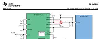

Is the inductor position on page 121 of SWCS049S wrong?

No, the inductor is placed correctly. This is also shown in the TPS65911A User's Guide for 66AK2G12 Processor , Figure 2.

Hi Conner,
Thank you for your reply.
Both figures are wrong.
The "dot" between FETs is missing.
Dice-K
My apologies Dice-K. After reviewing, you are correct. Since these pins are for a controller, the FETs are external to the device and a dot should indeed by placed there for the switching node.

Hi Conner,
Thank you for reviewing.
I would appreciate it if you could correct this typo along with the PWRDN pin typo.
