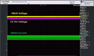

When a 5V/1.5A source device was connected to TPS25750D with the prototype board, which was in the following status.
It seems to be recognizing charger current 1.5A as intended, but the actual USB supply current is only 0.5A.
- CC pin voltage was 0.964Vrms
- Cc1PinState of 0x69 TYPEC_STATE Register was 04h (1.5A Advertisement detected (Sink only))

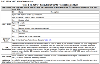

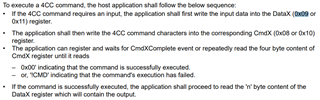

    You can use 4CC command 'I2Cw' to overwrite the BQ register through the PD as an I2C pass through (see excerpt from the Technical Reference Manual below):
    In order to send a 4CC command, follow the sequence described below (this applies to I2Cw and I2Cr):
    By the way, I would like to ask you a question regarding Chuck-san's Q4 and Q5 answers above.
    There were cases where TPS25750 sank the current before PS_READY was sent from the SOURCE device when analyzing USB bus with USB protocol analyzer. This is status before TPS25750 updates BQ25792's IINDPM and VINDPM and it seems there is a possibility that TPS25750 can sink 3A which is the default value.
    Do you have a PD log along with I2C scope capture of the I2C traffic between TPS25750 and BQ25792 of this occurrence? What is the test scenario in this case where TPS25750+BQ25792 is sinking current prior to PSReady? Was there already a PD contract in place before a new contract was negotiated? How about the source device capabilities?
    I'll follow up tomorrow with an example of I2Cw to re-configure register 0x05 (VINDPM) and 0x06 (IINDPM) of the BQ25792.

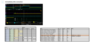

    For your additional questions, I would explain the entire process in the chronological order as follows.
    1. TPS25750 writes 3000mA to IINDPM_8:0 before negotiation is completed
    2. Negotiation completed
    3. VBUS voltage and current increase, current continues to flow at 2.8A
    4. SOURCE device sends PS_RDY to TPS25750
    5. SOURCE device sends OCP to TPS25750
    6. TPS25750 writes 2000mA to IINDPM_8:0
    It would be very helpful for me if you can replicate this issue with EVM and provide a workaround.

  • Hi Kato-san,
    Understand the urgency, I am testing on my end and should have results by next Monday.
    If you have an Aardvark on your end, you can try running the attached batch mode example for how to setup I2Cw and re-configured the BQ25792 IINDPM (register 0x06) to 2A or any other value. You can follow up by sending 'I2Cr' to ensure 'I2Cw' executed correctly.
    Thanks and Regards,
    Raymond Lin
    Sample Batch Mode for 'I2Cw':  /cfs-file/__key/communityserver-discussions-components-files/196/I2Cw_5F00_Configuring_5F00_BQ25792_5F00_IINDPM_5F00_Register_5F00_Example.txt
    Sample Batch Mode for 'I2Cr': /cfs-file/__key/communityserver-discussions-components-files/196/I2Cr_5F00_Configuring_5F00_BQ25792_5F00_IINDPM_5F00_Register_5F00_Example.txt

  • Kato,
    The 4CC commands that Raymond has provided show the I2C transactions that will allow an External MCU to change in IINDPM register to set the current limit appropriately.
    The MCU system will need to process the I2Cs_IRQ, read the status register of the PD controller, determine that a 5V/1.5A PDO has been negotiated and then change the IINDPM register using the command the Raymond provided.
    Chuck
