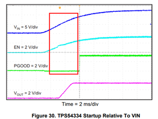

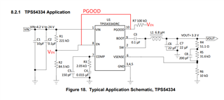

The customer would like to use PGOOD signal as EN signal.The purpose of this concept is for shut down the device when output voltage is abnormal.
Is it possible? please review below concept and let me know your opinion whether below concept is available or not.
If below concept is not possible, Is there any way to shutdown the device using PGOOD signal when output voltage is abnormal

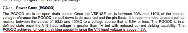

In red box, PGOOD signal is floating or GND?
Thank you.

    Sorry you can't. PG will be pulled low during this period that you point out.

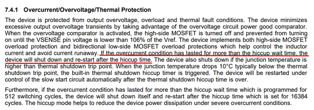

    Our device has overcurrent and overvoltage protection, but they are non-latch protection, which means device won't shutdown during protection.
    I think what you need is 'latch protection' parts that will shut down the devices when issue occurred. Please look at our TPS51396A.
