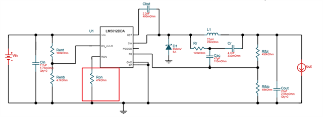

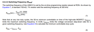

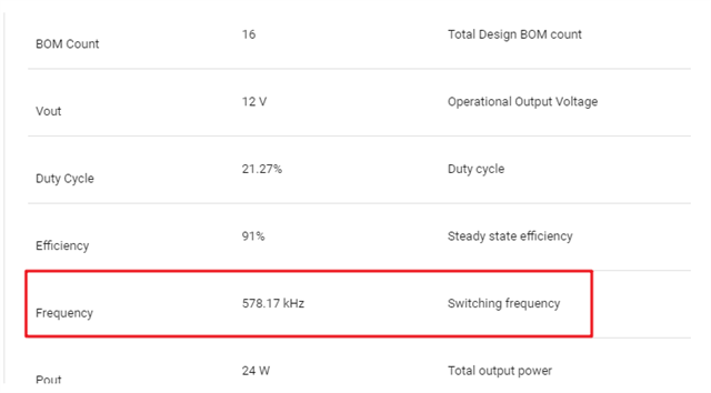

Hi team,
I have a question about the LM5012. When doing calculations in webench, the frequency is 578.17kHz, but according to the calculation of Equation 1 in the datasheet, it should be 12.22*2500/47=650kHz. Which calculated value should I believe?
Lillian
