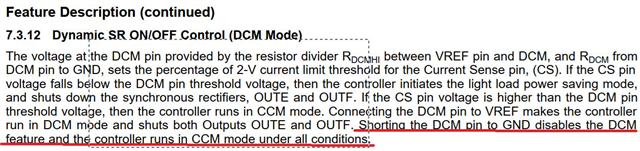

Because of the light load EMI problem, I tried to operate the IC in full CCM mode. I would like to know what special issues need to be paid attention to when operating in full CCM mode?
In addition, I changed a prototype from DCM to full CCM, and the SR MOS was damaged at 24V/0.2A (800W). Will this problem occur in full CCM mode?

    However when using synchronous rectifiers (SRs) the design can always be CCM.  This is was the data sheet was referring too.  However, if you are using SRs I would recommend using the DCM pin and disabling for the FETs have a reverse current going through them.  Reverse currents in FETs have a tendency to damage them when they turn off.  The following link will bring you to an application note that shows how to design with the UCC28950 in a PSFB and how to setup the DCM comparator.  https://www.ti.com/lit/an/slua560d/slua560d.pdf
