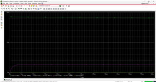

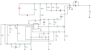

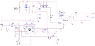

I am trying to do the simulation the UCC2856H accordance with WEBENCH suggested schematic. but could not able to achieve the output.
Observations are:
VDD is 19V
VFB observing 2.3V
rest all pind are seeing 0V
Specifications are:
VinMin = 40.0V VinMax = 200.0V Vout = 7.0V Iout = 3.0A
Here I am attaching the both schematics and simulated wavefomrs for your ref. PLease go thru and advise the issue. Many thanks in Advace.
  • Manoj,
    You describe the input voltage as DC but show the Webench and PSPICE schematic with AC input? Regardless, attached is a fundamental flyback design, using UCC28C43 in PSPICE for TI. I hope you can run this sim and verify it works, then slowly begin replacing components until you evolve to achieve your requirements. You should maybe start with replacing the PWM controller only then verify it still runs before moving on to redefine the power stage.
    Your sim is running but not behaving/switching as you expect. Try temporarily removing everything that is not required to make the converter switch (soft start, slope comp). You also have a couple connections that I am questioning below.
    1. No connection dots are shown at the circled areas - make sure these are connected.

    Connection are filne.
    I have tried removing SS & Slope comp earlier, issue still same. could you please help to share the Simulation for the above mentioned specifications!
