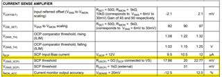

I want to prevent a path from overcurrent with a certain precision so I have several questions regarding the LM74910-Q1 component:
1.- What is the range of sensed voltages? I mean, between CS+ and CS-, for example if  the range is between 6 and 30mV or something like that.
2.- For calculating the minimum and maximun current limit, what are the values I have to take into account? Is the margin the one which is shown in V(SNS_SCP) with
      R(ISCP) = 0 Ohm or the one shown in IMON_ACC?
Thanks for your help.

    To calculate the OCP threshold variation, you will need to look at the below parameters which is the VREF in the block diagram below,

    3. Yes, I did. I have been doing some calculations in this design calculator but I don't know very well how the Minimum and Maximun Current Limit is calculated. This is because if the ILIM is calculated as follow: ILIM = 12 x RSET / (RSENSE x R(ILIM)) = 12 x RSET / ((VSENSE / ISCP) x RILIM)
    the variation in ILIM depends on the variation in VSNS and I understand that this variation is indicated in V(SNS_SCP) with R(ISCP) = 0 Ω if I connect ISCP to VS. But these values are different to the calculated with the design calculator.

  • Hi Jose,
    In the ILIM equation, the number '12' is related to V(SNS_TH) x 10 = 1.22 x 10.
    As the V(SNS_TH) threshold varies from 1.08V to 1.32V, the factor 12 in ILIM equation varies from 10.8 to 13.2.

  • Hi Jose,
    Due to the amplifier at CS+ and CS- pins, the differential voltage across CS+ and CS- will be 0V.
    So, RSENSE x ILOAD = RSET x ISET
    ISET is spilt into IILIM and IMON in the ration 1:9
    So, IILIM = (1/10) x ISET
    Voltage on ILIM pin is compared to VSNS_TH and when the voltage is greater than VSNS_TH rising threshold (1.22V) the TMR starts charging.
    VILIM = IILIM x RLIM
    VILIM = (1/10) x ISET x RLIM
    VILIM = (1/10) x (RSENSE x ILOAD / RSET) x RLIM
    When Voltage on ILIM pin reaches 1.22V, the OCP threshold (ILIM) is hit, this means the ILOAD = ILIM when VILIM = 1.22V
    1.22V = (1/10) x (RSENSE x ILIM / RSET) x RLIM
    So, the over current threshold, ILIM will be
    ILIM = 12.2V x RSET / (RSENSE x RLIM )
    For Over Current Protection threshold calculation you will have to take into account the V(SNS_TH) rising threshold as that is when the TMR starts charging considering an over current condition. Once the TMR starts charging, the voltage on the ILIM pin has to fall below the V(SNS_TH) falling threshold for the TMR to stop charging and come out of OCP condition. For more understanding, please refer to section ,'9.3.3 Overcurrent Protection (CS+, CS-, ILIM, IMON, TMR)' of the datasheet.
