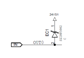

  • Hello Elizabeth,
    We have only TVS diode @output, critical frequency is around 700kHz. I is done during test when frequencies are changing all the time so we could not fix it on a single one.
    Miroslav

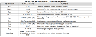

  • Hi Miroslav,
    It sounds like you are preforming some sort of EMI testing?
    If so, I would recommend using the recommended external components listed in Table 10-1 of the datasheet, specifically the output capacitor of 22nF I am not seeing in your schematic.
    Elizabeth
  • Hello Elizabeth,
    We do have 22nF as well on new design. But situation is even worse, because problematic frequencies starts at already 500kHz.(without 22nF starts at 700kHz)
    To relate this to previous topic, without external capacitor output charges up to some voltage and when you touch it with wire to ground -> it sparks!?!?!?!
    To get it to spark state we need to wait some time, maybe one minute.  Output charges even faster with external capacitor but it is more less easy to understand. But without...it is not normal.
    We do not have a problem with sparking, it is unimportant for us. But this EMI is a problem. Please explore this topic further.

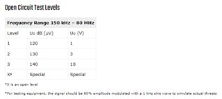

  • Hello Elizabeth,
    Maybe you can find out more from this link https://www.atecorp.com/compliance-standards/iec/iec-61000-4-6
    Or this one https://www.emcstandards.co.uk/files/61000-4-6_immunity_to_conducted_rfi_2_1.pdf
    Those ones I was able to search on internet that are accessible. Thanx to authors
    Miroslav

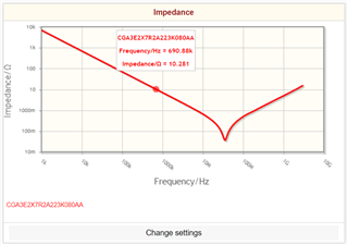

  • Hi Miroslav,
    The reason a capacitor near the connector would help is a capacitor functions as a shunt to ground at high frequency. If we take a look at the capacitor on our evaluation module (C0603C223K1RAC7867), the device has an impendence of ~10ohms at 700MHz.
    I am unfortunately not seeing a similar plot for the capacitor part number you have provided, but it should be a similar curve. To further this example, using the EVM capacitor on the output at 700MHz, if the capacitor is soldered down and placed next to the connector, the disturbance will go to ground through 10ohms.
    Loading the device (for example when you are drawing 50mA) would solve this issue in a similar way. A load provides a path for the disturbance to go to ground, reducing the power the device sees at the output.
    Without any external circuitry, a 20V conducted disturbance at the output could bias the gate if it is stronger than the pull-down structure on the gate and the device's digital protection. In this case, the device could hold up the output high as you are seeing. What we need to do is mitigate this voltage.
    Some questions for you which would be very helpful for our debug:
    • After reviewing the standard you provided, it appears the voltage for the test should be at most 10V under a level 3/Zone C condition; is there a particular reason 20V is being attempted here? Is 20V adherence required for the end-product?

  • Hi Miroslav,
    Thank you for providing that information!
    We suspect the reason the device is not turning fully off is gate to source coupling through the internal gate to source capacitor causing the gate to charge.
    To reduce the power seen at the output and allow the gate to pull low, we need to diffuse the disturbance to ground. This can be done using a capacitor soldered down and placed close to the connector.
    I suspect the issue with the current setup is the capacitor being used, and where it's placed. If a 50mA load (400ohm load) resolves the disturbance, then a capacitor which is 10ohms at 400-900kHz should resolve the disturbance similarly.
    I am not able to find any frequency vs. impedance information on the capacitor you are using; would it be possible to use a C0603C223K1RAC7867 capacitor soldered down and as close to the external connector as possible and rerun the test?

    It is possible the increased capacitance could affect other standards or tests as they are very system dependent.
    For clarification on our 22nF recommendation, we recommend an output capacitance of 22nF for the purpose of filtering out voltage transients (for example, ESD, RF transients), and additional capacitance to that will help filter out voltage transients with eventually diminishing returns.
    While I do not foresee a concern, our recommendation is to test all of the standards you need to pass to ensure your solution is robust.
